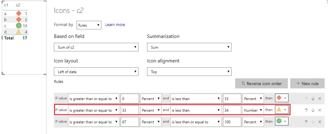

I use a very simple sample data to demonstrate the results of the percentage conditional format. Please explain the calculation logic.
The table has only four rows,take 10 as the maximum which is 100%, 1 and 2 is below 33 percent, It turns out that this is true, 4 is 40 percent of 10, but actually it is between 33 and 34 percent . can anyone explain it?

The default logic is Pct of min and max values. Your min is 0 and max is 10. So the breaks will be auto set at 3.3, 6.6
in your case, your settings are not MECE. If you change your third setting to start at 34, I assume it will work. My guess is this is a bug.

Thanks Matt, Yes, My settings are not MECE, I set it thay way on purpose. My question is, based on the current setting, the value 4 is between 33% and 34%. In the case where 10 is the maximum, this interval corresponds to 3.3 and 3.4. so We can conclude that 3.3<=4<3.4 which is obviously wrong

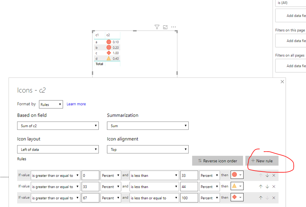

The picture you provided is the the default rules.
It applies a red diamond to the lower 33% of your data, a yellow triangle to the middle 33%, and a green circle to the upper 33%.
So however you change it, it will show by default.
To create your own rule, please delete the default ones, then create new rules.
