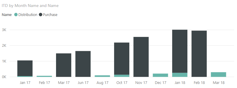

Hey everyone, I'm having an issue calculating the ITD value of my dataset. It seems like it should be pretty simple but I can't get it to work properly. Here's what my sample data looks like: ...
- 8 years ago
Never mind, got it figured out. As counterintuitive as it would seem, I had to remove the relationship between the Data table and the Categories table.
Hopefully this helps someone else in the same boat.

When adding the filter CurrentCategory to your measure you are forcing the calculation to cgeck if the category exists on your table if not it won't return value try to remove the last part of the filter from your calculation being in the measure only the date filter.
