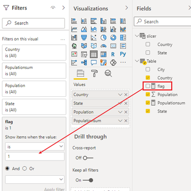

Hi, Prabhu_MDU ;
According to your description, if you use table to show it ,you could create a measure to calculate sum of state, and create a flag to filter it ; if you use matrix to show it, you only create a flag measure to filter .
Table:
a)create a measure to calculate sum
Populationsum = CALCULATE(SUM([Population]),ALLEXCEPT('Table','Table'[Country ],'Table'[State]))
b)create a flag measure
flag =
var _ccountry=SUMMARIZE('slicer',[Country ])
return IF(MAX([Country ]) in _ccountry||MAX([State])=MAX('slicer'[State]),1,0)
c)put flag measure into filter.
The final output is shown below:
Matrix:
a)create a flag measure
flag = var _ccountry=SUMMARIZE('slicer',[Country ])
b)put it into filter.
