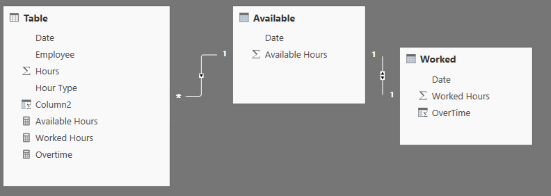

  • Hi navarrobr,
    In your scenario, you can create two new tables 'Woked' and 'Available', then build a relationship between those two tables. Please follow steps below:
    1. Create 'Available' table.
    Available = SUMMARIZE('Table','Table'[Date],"Available Hours",CALCULATE(SUM('Table'[Hours]),'Table'[Hour Type]="available"))
    2. Create 'Worked' table' and a calculated column 'OverTime'.
    Worked = SUMMARIZE('Table','Table'[Date],"Worked Hours",CALCULATE(SUM('Table'[Hours]),'Table'[Hour Type]="worked"))
    OverTime = IF('Worked'[Worked Hours]>RELATED('Available'[Available Hours]),[Worked Hours]-RELATED('Available'[Available Hours]),0)
    3. Build relationships.
    4. Create a table visual.
    If you have any question, please feel free to ask.

  • v-qiuyu-msft's avatar
    v-qiuyu-msft
    Hi navarrobr,
    Qiuyun Yu
