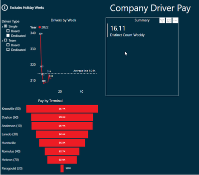

Hi, I wonder if anyone can help. I have a table called "Pay Detail" and I want to create a measure that shows the average number of drivers we paid each week over the year. However, I have filters by different "Driver Type", "Driver Kind - Dedicated" and "Terminal".
My visual below does that for me as I have the week number in the X axis and in the value I'm simply putting distinct count of the driver ID's (each driver has a unique ID) and the result is correct. However, I need to create a measure to the side that calculates this. So the average for my terminal in Knoxville is around 62 drivers for year 2022.
Essentially, I need to find the average number of drivers for each week in the year, but it to change when I click different Driver Types, Drivers Kind or Terminals.
Can anyone assist? Thanks!

Hi @DataInsights , so the issue I have with using the simple average measure from the calculated table is that the answer does not change if I click on for example a different terminal. The second screen shot answer remains the same if I click the Anderson (10) terminal and I need it to change.
The graph gives me the answer I need. For example screen shot 1 I have a hierachy slicer selected for Driver type = "Single", Driver kind = "Dedicated" and my average line number of drivers used each week in 2022 is 314 drivers. If I wanted to see this for a different terminal say "Knoxville 50" it changes to 61 and so on. It seems like I need to have many relationships from my main table to my new table I created to calculate the distinct count.
That's correct. You have to create relationships between the calculated table and the dimension tables. This isn't necessary in the alternate approach I mentioned, where you eliminate the intermediary calculated table and create a relationship between the date table and 'Pay Detail' table.
I used your work around method and it worked perfect. Thank you so much!
