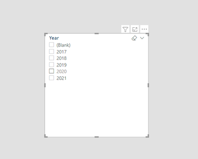

I am trying to add one more slicer into Power Bi Report with connection of Year - Month.
I created new column in Calendar table:
And add slicer with that column.
The problem is that in Year - Month slicer I am able to select dates without entries in main table. For example year 1899 which is not visible in year slicer.
I used same filters like in year or month slicer but in slicer Year - Month its not working.
What is the problem with that?

Hi Mr_Oli, This could be due to the filter direction. If you currently have the filter direction set to one direction (from your date table to the table you wish to filter) it would mean that the year-month column will not be filtered based on the content in the related table. So it will show all values that exist in the date table. You could change the filter direction to "both" for this relationship to filter the slicer. Or even better, reduce the date table to contain only the dates that your will require (based on your other slicers I would assume that starting the calendar at 2020 would perhaps already be sufficient).
before filter direction change
filter direction
after filter direction change
I can't change it to 'both' because I have another table after "Date" Table
