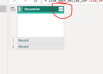

I don't know though how to define an sql query for V2 and have also a problems with this connector as it doesn't parse arrays well, I wanted to tell you that there is a way to expand the data for V1. Before loading the data for V1 press "Transform" and then - press the arrows to expand the data. Then there will be columns. I hope it could help you.
Best regards,
Lisa.
