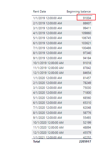

        the cumulative beginning balance suppose to be 91003 which is the sum of all beginning balance for all the leases except 35 and 38 as both Leases 35 and 38 started at April 2019(Period 4) and March 2019 (Period 3) respecitively, and they added according to it. Lease 35 value is 13210 (April 2019, period 4), and Lease 38 is 13210(March 2019, period 3). Please see the table below , so Lease 38 total Present value (13210) will add in March(Period 3) of Amortization Beg Balance, and Lease 35(13210) will add in April 2014 (period 4) as per your forumula is picking in period 1 for lease 35 and 38 which is not correct. I tried to do it, but couldn't. your help will be appreciated it.
        microsoft amortization
        please see period 1,2,3,4
        so these two lease supposed to be adjusted in amortization schedule in beginning balance by adding to period period 3 and period 4 during maortization balance (please see the table below). please help. I really appreciate your last effort
