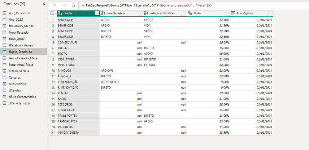

I'm going through a new process of creating a goal calculation tool in my company using PowerBI.
I have two tables >
fMeta_Escolhida - In it I have the sectors, subsectors and their respective % in target
fAno_Passado_Meta - In it I bring with the merge the Goal column of the previous table, but what happens is the following, it duplicates the rows, in addition, I have subcategories, which should apply correct %, but it duplicates, taking the two subcategories;
image 01 - My fMeta_Escolhida
image 02 - fAno_Passado_Meta - I put the filter to show, where the external subsector was supposed to be 32%, but it creates a line with 11% and another with 32%.
Why does this occur?
Is there a way, other than merging, to bring the values of each sector and subsector?

Are you merging your queries on the Celula Column by any chance?
Since the fMeta_Escolhida has two values for Celula = INDAIATUBA (one is 32% the other is 11%) there will be a dupliucate in the resulting table.
If you're looking to only get one value, then you need to be more specific with how you join your tables - either create a new composite column (i.e concatenate a few columns to create a unique primary key to use in your join), or you can filter / remove duplicates in the fMeta_Escolhida so that only the value you want will be available in the merge.
