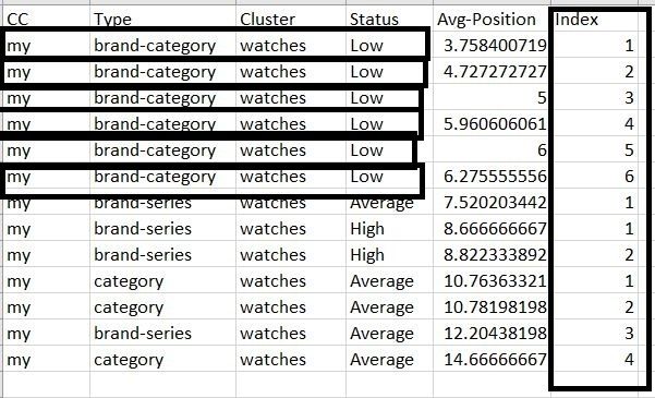

Add calculated index column by DAX
Dear Friends,
I have table as a below,I would be happy if you guide me how I can add the calculated index column to the table a New column by a DAX formula.
Thank you,
Myti

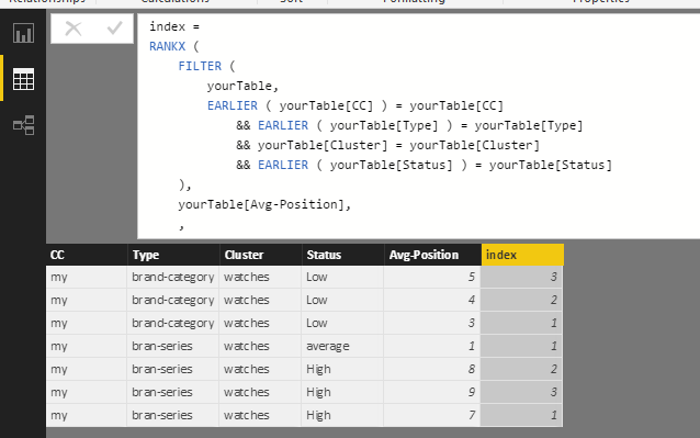

    Try to create a calculated column in DAX.
    index =
    RANKX (
        FILTER (
            yourTable,
            EARLIER ( yourTable[CC] ) = yourTable[CC]
                && EARLIER ( yourTable[Type] ) = yourTable[Type]
                && yourTable[Cluster] = yourTable[Cluster]
                && EARLIER ( yourTable[Status] ) = yourTable[Status]
        yourTable[Avg-Position],
        ASC

    Can you explain the mechanics behind that Index column? If I am reading it correctly, you start at 1 and increment until the "Status" changes and then you start back at 1 and so on.
    My feelings are that you would have better success implementing this in "M" rather than DAX.
    • myti's avatar
      myti
      Icon for Helper II rankHelper II
      Thanks Greg_Deckler for your quick reply.
      My idea is that to add index based on value of Avg-Position.Changing is not only based on "status".It is based on the  the four first columns.
      Thank you
        myti

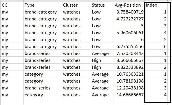

        Try the following steps
        1. Go to the editQuery of the table.
        2. Go to the Add Column Tab
        3. Add Index Column
        4. Rename that column as ColIndex
        5. Close the EditQuery
        6. Right Click Your table
        7. Click on New Column
        8. Paste the following code
            DesiredIndex = CALCULATE(COUNT([ColIndex]), ALL('Table2'),
                                      FILTER('Table2', [ColIndex] <=EARLIER([ColIndex])),
                                     FILTER('Table2', [CC]=EARLIER([CC])),
                                     FILTER('Table2', [Type]=EARLIER([Type])),
                                    FILTER('Table2', [Cluster]=EARLIER([Cluster])),
                                   FILTER('Table2', [Status]=EARLIER([Status]))
        You will get the result you want.
        If this works for you please accept this as solution and also give KUDOS.
        Cheers
        CheenuSing
