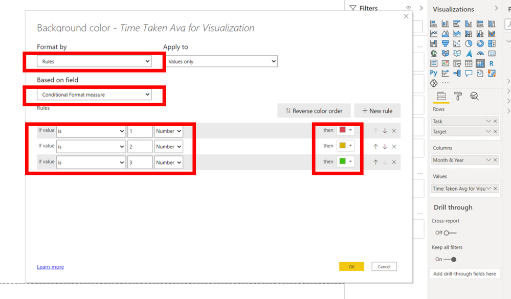

I also want to be able to conditionally format each 'cell' under the 'Current' column and each of the rolling month columns, so that the cell turns red if it's above 5% of the target, yellow if within 5% of target (above or below), and green if over 5% below target.

Hi, @ArslanManzoor
Please check the below steps.
Write a measure something like below.

@Jihwan_Kim Hello, I'm replying on behalf of Arslan. He has said:
Great, thanks , the conditional formatting now works.

Thanks @Jihwan_Kim , I have managed to get the table to work for my data.
Is there a solution for my conditional formatting question above I can use in this table?
Hi, @ArslanManzoor
