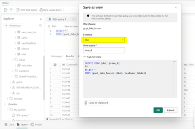

Sure. See attached.Select Query and then Save as viewSelect Query and then Save as viewError thrownError thrown
Hi @erkuiper - Thanks for using Fabric Community.
Can you please share some screenshots of your issue, so I can help you better.
