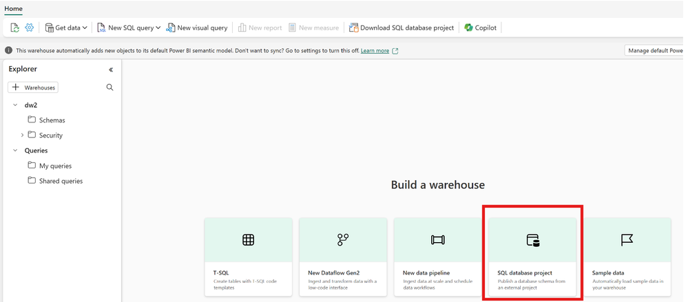

Hi @Umasankar_Sane
Does this warehouse reference a lakehouse? If so, this might be a cause of the error. As the Lakehouses are not supported enough be deployment pipelines. To resolve this, you may try two options:
  1. Manually create the lakehouse in the destination workspace WITH all the tables and views that exist in the source workspace.
  2. Remove any reference to the lakehouse in the warehouse. (Note: Second option is only needed if for some reason first option is not viable.)
If above options don't work, and the warehouse doesn't reference a lakehouse, please do following steps to try to find more detailed error messages:
1) Export source datawarehouse - click the "Download SQL database project" from within the warehouse editor:
2) Create a new warehouse
3) Import the zip file exported in step 1 INTO DESTINATION FOLDER (this is because the warehouse may be referencing a table in a different artifact that does exist in the source but not the destination):
4) If import fails, it should show the details of the failure. Based on this, you can determine what needs to be fixed for the pipeline to succeed.
If the import is successful, but the deployment pipeline isn't, please open a support ticket to Microsoft to investigate this issue further.
Jing
