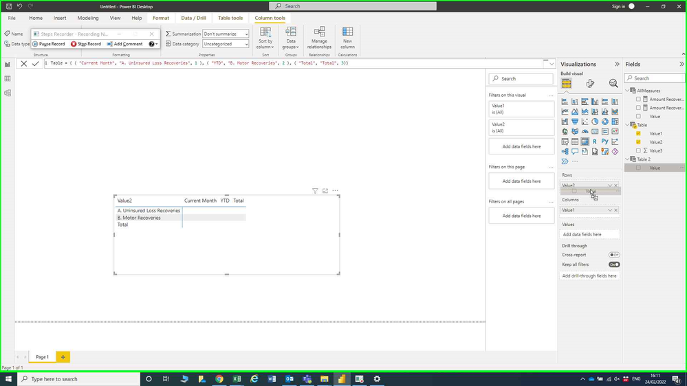

Thats worked - there are no errors. So where do you want me to put the fields in the cross tab visualisation like this or is there a stage inbetween?
Hi @spandy34
It should work but we need to trick PowerBi in oreder to reach our distination. See in this screenshot is working with me
In order to trick it we need to modify the code for 'Table'
Table = { ( "Current Month", "A. Uninsured Loss Recoveries", 1 ), ( "YTD", "B. Motor Recoveries", 2 ), ( "Total", "Total", 3)}
Now follow the following steps: please follow the mouse curser
Hi @tamerj1
The help you have provided has been amazing - here is the result below. There are the other rows to add ie Amount Recovered, Team Fee Income for both Uninsured Loss Recoveries and Motor Recoveries. Is this too much to try and help me with or are you okay too? I understand I have take a lot of your time already?
USe the same measure. the only thing yuou need to change is the measure names inside the master measure. So you will have total 3 master measures. Create the other two and add them to the values of the matrix
Im my example can you tell me what meaure you are referring to when you say " Use the same measure" do you mean copy them ?
