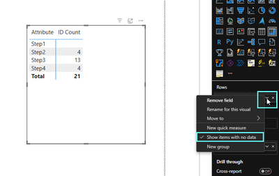

    Here is the screenshot of the desired result in Power BI:
    By default, "Step1" will not be displayed due to its blank or zero ID count. To make it visible, ensure that you check the "Show Items with no data". Below is a screenshot indicating where you can find this option:
    Click on the "Attribute" in the Rows section and then, click on "Show items with no data"
    I am attaching the Power BI file for your reference. Please review it and let me know if you have any further queries.
