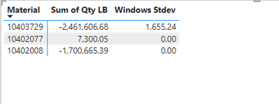

I have attached the Power BI file for reference
The window_stdev should be calculated for the column "qty lb" across the date column "Pstng Date"
like this ?
What window size are we talking here? months in years?
The standard deviation needs to be calculated for the entire window size. For example here the window_size is 3 so first the standard deviation is calculated based on the three values of Qty LB for the material
Material Qty LB
10403709 -2,461,606.68,
10402077 -1,700,665.39,
10402008 7,300
The window_stdev is standard deviation first calculated for the three material values (-2,461,606.68, -1,700,665.39, 7,300) then two then NULL
This is a direct formula in tableau Window_stdev(sum(qty LB))
My question is how to convert this to power BI DAX
there are no direct formula avaialable. So how to do this?
I would think you have to use SUMMARIZE first to freeze the window and then run STDEV over the resulting table. The tricky part will be to figure out what to SUMMARIZE over.
Summarize should be based on material.
CAn you send me a DAX using summarize to achieve windows_stdev?
i haven't got the result for this.
