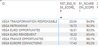

Hi, I am looking to figure out a solution in Power BI that can do conditional formatting to a matrix where each column has its rule to decide how to colour its background. The rules are saved in a table called 'Control File'. My thought is to create a measure for each column in the matrix and the measure can process the relevant rules (rows) in the 'Control File' and return a value of -1(red), 0(no color) or 1(green). Then the measure is used in the conditional formatting window of each column in the matrix. To be noted, some columns in the matrix are fed by measures.
This is the matrix and I just included two columns here for example. There are more to the right. ID represents different portfolios. NET_ESG_RISK_SCORE_P is a column from the table 'BI_GREEN_BATCHING1' and B1_%CARBON_SCOPE1 is a measure calculated on top of some columns in another table.

The matrix is mains fed be the table 'BI_GREEN_BATCHING1'
