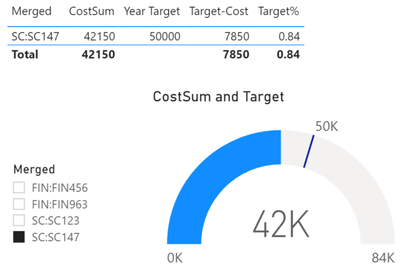

Hello @AlB ,
Thank you for your reply , that was very helpful.
You also gave me the opportunity to dig a little deeper and recreate the same graphs by using measures.
The tricky one was to capture the correct target per area/cost centre.
This is the measure I came up with.
Target = CALCULATE(MAX(Target[Year Target]))
Once I sorted this out, I was then able to create the below graph.
