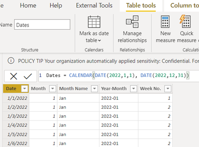

  • Hi:
    In your date table, please mark column date as Date Table.  Then add calc columns to date table.
    WEEK No. = WEEKNUM(DateTableName[Date])
    YEAR = YEAR(DateTableName[Date])
    Month No. = MONTH(DateTableName[Date])
    Connect your date table date filed to your facttable date column, to create a relationship.
    Stay with original measure Total = SUM(Table[offlinetime])
    Add slicer taking week no field from date table. picture below.
    Use slicer to get the the values you want for sum of offlinetime.
