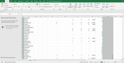

I have to measuere one is current month month to date sales "[CM MTD Sales]"
2nd is Qualified Units "[Qualified Units]"
about two measure related to two differnect tables like sales and qualificat units for incentives. belwo DAX measure works fine in matrix on row levle or party level but its net total in not corrected, in net total the dax again apply formula conditions and return less value from both Variable although i wants to sum up the data which is created by row level. plz guide how to solve the issue.
Pic is attached:
Applied measure works correctly on row or party lelve in martix but net total is not corrected:

hi @123abc
Please use this measure. Exported to csv with original measure and sum is 1455. Please note that this measure will always calculate at this level Account Number, Party Name and Branch. If you happen to include another dimension column to visual, you will have to adjust SUMMARIZE.
This is how this measure is working.
Creating a table using summarize with Account Number, Party Name and Branch. Since SUMX is an iterator, it will iterate each row of result of SUMMARIZE.
Each combiation of Account Number, Party Name and Branch will act as a filter for your measures
[CM MTD Sales] and [Qualified Units Nov 23 Onwards].

Hi @123abc ,
This is how your measure is currently working.
At row level there is a filter coming from visual, but at total level there is no filter from visual.
So TotalSum = 2986 and TotalQualified = 4277, that is why you are getting total as TotalSum.
IF(
                TotalQualified > TotalSum,
                TotalSum,
                0
Use SUMX to fix this. and call your measures inside SUMX and pass the filters manually(though filters are propagated automatically during context transition).
Please refre to this article.
Update :
Something like this, Since SUMX is an iterator. It will iterate over all products and return value based on your condition. Also your measure invokes context transition and will calculate for each product.
Modify Summarize to modify the filters(Example I see Party and Branch as filters in screenshot).
