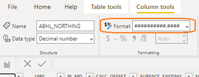

You can customize the format of your data by using custom numeric format characters.
This is what I used to remove trailing 0's from my decimal number.
https://learn.microsoft.com/en-us/dax/format-function-dax
Maybe it did not solve @EF 's problem but it sure did solve mine!!!
