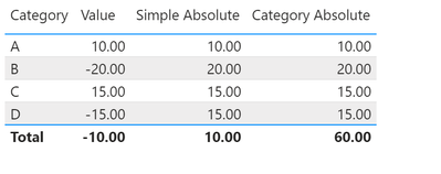

@Greg_Deckler I read trough the links you provided and I am already doing everything as optimally as possible. I abstracted out the main calculation that is causing the issue into a simple example: PowerBI Absolute Value.pbix
The calculated measure returns the same result as the ABS function except for the totals. As you can see in the totals the absolute values for each category is summed up.
Category Absolute =
VAR __table =
SUMMARIZE (
'Table',
'Table'[Category],
"Absolute", ABS ( SUM ( 'Table'[Value] ) )
RETURN SUMX ( __table, [Absolute] )
Can I do this somehow without using SUMMARIZE ?
