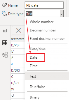

Hi @Nihed
Firstly, you need to change the type of date value from text to Date type.
then, there are something need to be checked,
