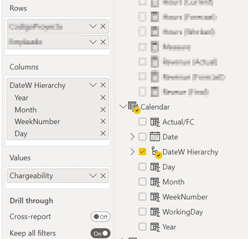

I'm trying to solve the following measure. I have a table with a list of dates with accounted hours for each date, and I want to calculate the ratio between the total hours for a period over the maximum, which I define as the total number of working days for these period multiplied by 8 hours each day.
This table is related with a Calendar table defined with CALENDARAUTO().
I have a Power BI file version where this works using the following measure:
Chargeability =
DIVIDE(CALCULATE(SUM(TimeAccounted[Hours])),CALCULATE(COUNTROWS('Calendar')*8,FILTER('Calendar',WEEKDAY('Calendar'[Date],2)<=5)))
2022-10-08 01_46_51-Análisis de Rentabilidad de Proyectos_20221001 - Power BI Desktop.png
But in another Power BI file, the same measure with the same tables and relationships, doesn't work. It seems like if there is a conflict between the Date in the column and the measure.
2022-10-08 01_53_10-Análisis de Rentabilidad de Proyectos_20221007 - Power BI Desktop.png
NOTE: The difference in the rows of the Matrix is because in the second Power BI file there are less items to show.
2022-10-08 01_59_31-Análisis de Rentabilidad de Proyectos_20221007 - Power BI Desktop.png
I have checked one Power BI file and the other during so many hours and I cannot find a difference that could make this difference in the behaivour of both measures. I have created debugging tables to see what is hapenning with this measure and simply doesn't work when used with the Date of the Calendar table. It seems there is a conflict, but I cannot realize what.
Any suggestion or idea?
Please help, I spent a lot of hours and cannot understand where is the problem. What I'm doing wrong?

Hi daXtreme,
Your reflections made me find the problem. Thank you very much!
At the end, the DAX was ok. The problem was in the relationships of the model. In one of them there was a both direction relationship between the Calendar Date and another fact table that was related, at the same time, with a dimmension table that was related with the original fact table. Changing the cross filter direction to Single did the trick.
Thanks again!
