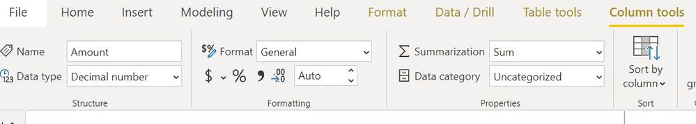

I did check the Format, but if Power BI thinks it's a date, you're only allowed to choose between Date Formats.

harshnathani
HI @matthias_vc ,
Change the format.
Harsh Nathani
Did I answer your question? Mark my post as a solution! Appreciate with a Kudos!! (Click the Thumbs Up Button)
In the meantime I did figure it out. Apparently Power BI doesn't always see the deduction of two Dates as a number.
To force it there is apparently a trick (multiplying by 1). So I rewrote my DAX to this:
