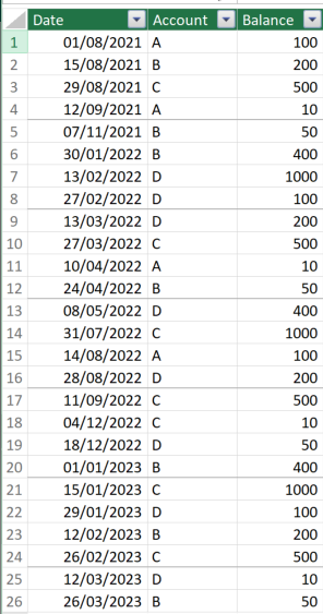

I have a set of data summarised as below:
DateAccountBalance
26/03/2023B50
12/03/2023D10
26/02/2023C500
12/02/2023B200
29/01/2023D100
15/01/2023C1000
01/01/2023B400
18/12/2022D50
04/12/2022C10
11/09/2022C500
28/08/2022D200
14/08/2022A100
31/07/2022C1000
08/05/2022D400
24/04/2022B50
10/04/2022A10
27/03/2022C500
13/03/2022D200
27/02/2022D100
13/02/2022D1000
30/01/2022B400
07/11/2021B50
12/09/2021A10
29/08/2021C500
15/08/2021B200
01/08/2021A100
"Date" column, which is the date the value of column "Balance" changes/updates. The "Date" column is linked to the Calendar table in the data model.
"Account" column, which is the name of the account the "Balance" column relates to. The number and name of accounts is variable (new accounts will be created and existing accounts will be closed)
"Balance" column contains the values to be evaluated.
I want to create a measure that returns the balance in a given date (filtered by the calendar table) regardless the the set of data contains an entry for that date or not. If there is an entry, it's straight forward but if there isn't, the measure has to look for the last time the value was updated (maybe months or years ago) for the related account (other accounts might have been updated recently)
I've tried for many hours with commands such as LASTNONBLANK() but always get a lot of problems.
The contextual filters must still work as I will use the measure in a pivot table with data sorted by the Calendar dates and by the account names (and others)
Thank you very much.
Kind regards
Miguel
