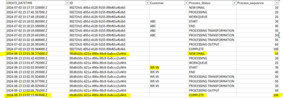

The Issue is for some of the GUIDs both 'New Email Time' and 'Complete Status Time' is picking up the same datetime value which is of 'New Email' status. Ex- for GUID highlighted for both status calculations same value is being picked hence showing 0Min0Sec

  • Thank you rajendraongole1  and BeaBF . I think it would be better if I give the whole requirement.
    Basically , In the sample data below - I want find the average time taken for prrocessing at a customer level. A process is said to be complete only when it starts with a 'New Email' , Process seq = 10 and ends with 'Complete' Status -Process seq = 100. If anything else its an incomplete process and can be considered as 0(processing time) for ease of calculation.
    In the below sample data - Expected output - for Customer 'WX V5' , ID = '00d8d10c%' time taken for processing =
    2024-08-13 13:03:13 (createdatetime where process status = complete) - 2024-08-13 13:01:38 (createdatetime where process status = New Email) = 0:02:20 (hh:mm:ss) . Similarly for each ID for each customer we need to calculate the time taken for each successfull cycle and then find the average time for each customer. One customer could process multiple IDs. Hence ID is the lowest grain.
    Please advice . Hope the sample data helps give better clarity.
