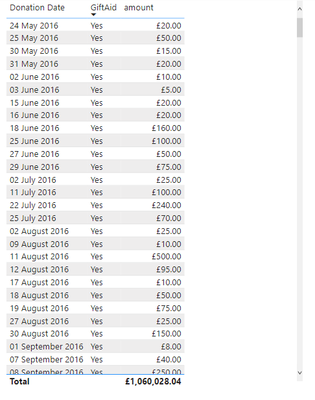

Below is an example of my data:
This is what I get when trying your latest statement:
Even if I type the table/column, still it doesn't work. Both columns ("GiftAid" and "amount") used for the calculation are from the same table. But I don't think it should matter, should it?
Please check once what is the datatype of GiftAid column and change it to text if it not a text .
It is a Text. And it's not a measure, it's a column.
