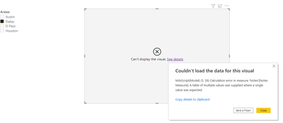

However, when I select an area, I get an error instead of the table displaying the notes (screenshot attached below):

Since there are multiple notes in one area, you cannot get the correct return result.
Try to modify the measures as follows:
Notes Measure =
IF( ISFILTERED(Areas[Area]) = TRUE, CONCATENATEX(values(Notes[Notes]), [Notes],"; "),
    "To see notes, please select a Service Area from the Service Area Slicer")
