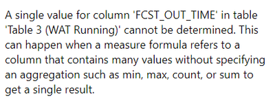

      Jihwan_Kim  It seems that I can't use the function RANK() on my laptop. How can I fix, thank you!
        And there's also another error message

      Irwan The error is as above. How can I fix it? Thank you!

        hello Anonymous
        it couldnt find the column probably because the column name that i wrote is different from your column name.
        otherwise please check whether you use measure or calculated column.
        Jihwan_Kim 's solution is using measure while my solution is calculated column.
        That systax error is Jihwan_Kim 's solution.
        you are free to use either of them depend on your needs but please do take a note that writing DAX in calculated column and measure is slightly different.
        Hope this will help you.
        Thank you.
