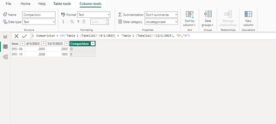

here is my solution:
To achieve this effect, the table is mainly converted through the pivot column, and the corresponding effect is derived by comparing it using a DAX expression.
First step, we need to import data to power BI desktop , and click transform data :
And then, we click transform >> Pivot column:
Note: We need to select the date column and then click on the pivot column
And then, values column we select amount >> click OK. And then, we click close and apply:
And then, we click table view >> new column:
Now, We enter the DAX expression:
IF('Table 1 (Tabelle1)'[4/1/2023] = 'Table 1 (Tabelle1)'[12/1/2023], "O","X")

Hi @Anonymous ,
Thank you for your support. I can achieve my results using these steps.
