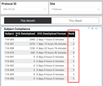

[Help] Add a Rank column correctly in a Chart of type Table based on the summary metrics
Basic report style
I have so far implemented this requirement, but the measurement of 'Rank' in 'Subject Compliance' is incorrect. I achieved the desired effect by limiting the value of the chart filter 'ECG DataUpload'.
Report content
  1. The chart type for 'Subject Compliance' is Table. There are three slicers acting as filters, Protocol ID, Site, and Period.Slicer Protocol ID and Period can be selected only in one option. Site supports multiple options and is selected all by default.
  2. The first column 'Subject' displayed in 'Subject Compliance' is determined by the filter of the slicer Protocol ID and Site. Not affected by slicer Period screening.
  3. The second column of 'ECG DataUpload' displayed for 'Subject Compliance' is an aggregate metric that represents the total number of data uploads for each Subject during the selected statistical Period as determined after the selected Protocol ID selected the Site.

Help content
As shown in the image content of the Basic report style module, the Subject Compliance also needs to display a 'Rank' column.
The meaning of 'Rank' is that each Subject, determined after the Protocol ID and Site are selected, is ranked according to the metric 'ECG DataUpload' shown in the second column.
Theoretically expected Rank implementation effect is shown in the figure below:
Wrong Rank demonstration
I tried to build a few ‘Rank’ metrics myself, but there were a few issues that made it impossible to achieve the desired display.
Problem manifestation 1: The calculated Rank value is incorrect, all of which are 1; However, the slicer can take effect normally and does not affect the display of the Subject.

Current status
I used 'Rank' for the third question type above and fulfilled the predetermined requirement by restricting the chart filter 'ECG DataUpload' to not be empty.
Rank = RANKX(
    ALLSELECTED('Relation_SubjectSite'[Subject]),
    [ECG DataUpload],
    DESC,
    DENSE
But in fact, the measurement formula of this Rank is itself wrong, and is a requirement that is implemented through other constraints.
How do you create a Rank measure that itself meets your requirements?

Sorry, I thought I had fulfilled the requirement by limiting chart filters, but when I added a new column to 'Subject Compliance', the Rank changed in a way I didn't understand.
The current Rank metric expression:
Rank = RANKX(
    [ECG DataUpload],
    DESC,
    DENSE
Report display
New unknown change
I have added a new column of 'first_upload' to the 'Subject Compliance' chart. The first column of Subject and the second 'ECG DataUpload' and the third 'ECG DataUpload Format' are not affected, but the 'Rank' value has changed.
The 'first_upload' is not a metric, but a column in the underlying table in the semantic model. And adding 'first_upload' to the graph does not change the results of the 'Subject' and metric 'ECG DataUpload'.
