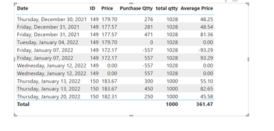

I'm having a problem with a measure. Total QTY is ok, I want it to show the total purchased regardless the filter context.
The problem is that I try to get the average price this way:
As you can see in the table, the measure it's not dividing by the total quantity (1028), instead it's doing it by the normal quantity.
Can anyone help me with this?
hello thank you for providing details,
kidly change the first measure i provided to :
total qtty = CALCULATE(SUM(HelpBi[Purchase Qtty]),ALL(HelpBi),HelpBi[ID]=MAX(HelpBi[ID]))
i added some sample to show you how it work:
 please tell me if it works if it does please accept as solution to help other users

Hi @Anonymous !
I'm copying the table below with an extra column (productId).
The problem of using ALL is that it removes the product filter and I need the measure to calculate the average price for the selected product so using ALL is not working.
Thank you so much @Anonymous ! This was exactly what I was needing! 😀
