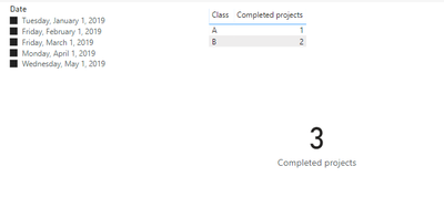

Hi @azeem_3a ,
Based on what you have presented I can duplicate your requested output. I have added a column in Power Query, although you can add it in Power BI. Simple if statement comparing the Plan and Actual and if not equal give it a 1. Call it Not completed.  My table is call code. Then a measure.
Distinct count of projects = DISTINCTCOUNT(code[Code])
and another
Completed projects = [Distinct count of projects] - max(code[Not completed])
works on a card or table.
If this solves your issues, please mark it as the solution, so that others can find it easily. Kudos are nice too.
Nathaniel

Hi @azeem_3a ,
Sorry, I did miss that you were going to select multiple months.
Hi @azeem_3a ,
So are these codes cumulative? What if April was the uncompleted code, and we went Jan - May, and May was completed would we get a zero or a one for that code?
Thanks,
Hi @azeem_3a ,
and another
Nathaniel
