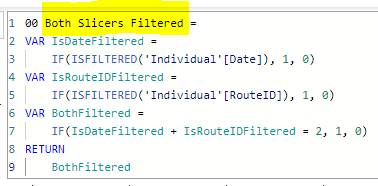

Step 1 - Create a measure to check if BOTH the Date AND RouteID are being filtered.
Step 2 - Select the "OUTPUT" table visual, and add the measure as a Filter on the visual.
When the Date & RouteID are not selected, or only 1 of them is selected, no results are shown in the OUTPUT.
However, when both Date AND RouteID are selected, then the OUTPUT shows results:
