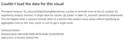

Hi @tamerj1 ,
The DAX says "Cannot find name [glt_trdate]" with the following message when the measure is added to the table:
Oh! My mistake. Please try

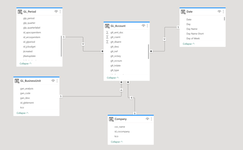

One more thing do you really think that it's not worth mentioning that the data os coming from two different tables? Do you really think that relationship are irrelevant and they do not matter? Please provide me with the complete picture to avoid wasting more time and effort.
I am trying to be as helpful as possible with my limited knowledge of DAX. I am new to this, which is why I am asking the forum. Also, I have the tables referenced in the original post.
'Date'[Date] -> 'GL_Account'[glt_trdate], which is the transaction date.
'Company'[kco] -> 'GL_Account'[kco], which is 2 companies codes, 22 and 30, referencing the 2 companies in the dataset.
'GL_BusinessUnit'[id_glelement] -> 'GL_Account'[id_glelement], which have bank codes for the different divisions of the 2 companies.
'GL_Period'[id_glperiod] -> 'GL_Account'[id_glperiod], the FinancialPeriod in yyyy-mm-dd format.
This would be a calculated column.
But please, I am trying to be helpful. If I am not being clear, just ask away as I do not know what is required. Thank you.
