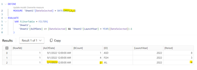

It's working fine when I evaluate it and 'hardcode' the date that is filtered:
But it's not working when I create it on the report view:
- DateSelected measure seems correct
- DateSelected = SELECTEDVALUE(Sheet1[AsOfDate])
- Tab result is all wrong
The slicer is having a Year-Month column from my Date table that seems to have a proper relationship with the 'Sheet1' tableloisloriot_9-1701440443619.png
I guess my issue is somewhere around my DateSelected measure / relationship with the Date table not able to have the correct context but I don't understand why obviously.

There's no such thing as a "dynamic" table in Power BI. There are computed tables, but they are computed on the refresh (load) of the model, so the content will not take into account any slicers or filters in a report.
Having a SQL background myself, I have found that is not always helpfull in understanding Power BI concepts.
So my advice is not to focus on the SQL equivalent but focus on the input data and the modeling of that and the required report output.
Hello, I dynamic table as 'virtual' table or DAX table that will be re-calculated everytime a slicer selection is changing. It's not someting I can do on Power Query / to be refreshed with the dataset.
The DAX creating the table is working when I evaluating it, I think I'm just failing to understand who the context will work in that case.
