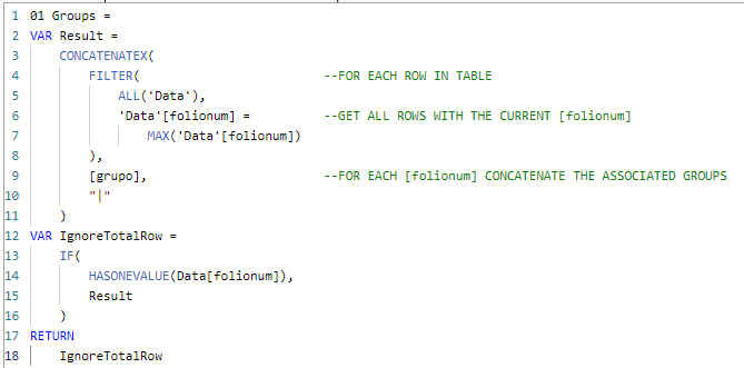

    OK, for some reason that I don't fully understand, I had to create a 3rd measure to make the total work correctly.
    (I believe it has to do with context transition.)
    Anyway, here are the 3 measures:
    Results:
    Hopefully this is helpful to you.
    Nathan

  • WinterMist's avatar
    WinterMist
    Icon for Impactful Individual rankImpactful Individual
    Sebastián_Limon
    Results:
    Nathan
