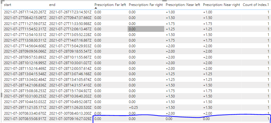

Hi @smpa01 , as suggested, I performed the following steps: Transform Data -> Add column -> Index column (From 1) -> Close and apply -> Add new measure -> Paste in the DAX. However, 0.00 appeared in the table and counted as 1 row. Have I missed out some steps here? Maybe you can help me on this? Appreciate for your further advice. Cheers
@SYChan_22  show the index in the matrix and use this as a measure

Hi @smpa01 , thanks for the valuable tips. The row that contains 0.00 isn't shown in the table anymore. As a final step, I would like to now count the rows in the index column in the matrix. How could we achieve this?

Hi @smpa01, referring to my original question, I would like to count the rows that meet the abovementioned conditions (yes, the solution worked!). Ultimately, I would like to show the total number of rows that met the conditions in the card visual instead of showing them in the matrix. Sorry for the misunderstanding and I hope I expressed it clear enough now.
@SYChan_22  did you actually really try putting the same measure in a card to see whether it works?
