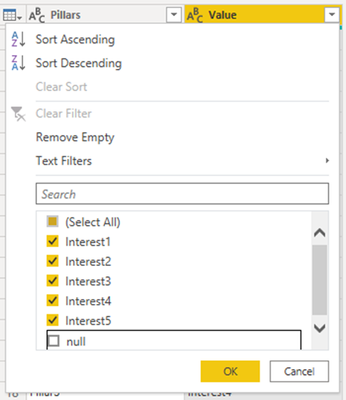

(2)The operation of selecting the first column and reversing the other columns.
(3)Delete the second column [Attribute].
(4)Filter on the [Values] column.
(5)Create a table.
(5)Create a table.

This actually worked, thank you very much!
Now the only thing I need to implement is date range.
