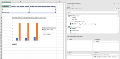

current data model
I've marked the columns which contain identical values.
How it looks like at the moment - worksheet "Pivot_table_chart"
blue bars = Distinct count of serial numbers of serviced products (working ✔️)
orange bars = Instead, here I'd like to show the values on x-axis (main) in relation to build products (not working ). Currently, the orange bars are representing the sum of build products in total, not according to the corresponding row labels. Underlying, there's a measure which is currently summing column "amount of products build" in table "tbl_build_products".

lbendlin
It's not two tables, it's four.  Here's the data model
Then you can create your measure as needed.
I used an implicit DISTINCTCOUNT for the columns, in Excel you will need to create an explicit measure.
See attached.
M4x
Thank you very much, that's what I've needed 😀
I replaced Products from tbl_serviced_products with Products from tbl_Products and now it's working 🙄 😁
Hint for myself or everybody else who's trying to achieve the same things: To be able to filter by build year, I've to add another column "build year" to tbl_serviced_products and link Year in tbl_year with build year in tbl_serviced_products. In my previous example files, I had Year in tbl_calendar linked to service year in tbl_serviced_products.
Thanks a lot, now I'm trying to adapt this to my original dataset.
M4x
I've adapted this to my original dataset and it's working great, thanks again @lbendlin ! 😁

Thank you very much for your reply!
Unfortunately, using Power BI is not possible for me (yet). I've recreated the data model you've shown in Excel and created three measures according to your example:
  • rate of service - part 1: Distinct count of SN (working ✔️)
=DISTINCTCOUNT(tbl_serviced_products[serial number])
  • rate of service - part 2: SUM of build products (not working  - I'm getting the total amount but I need it according to the product within the same row. This isn't a surprise, please have a look at my "statement" at the bottom)
=SUM(tbl_build_products[amount of products build])​
  • rate of service - part 3: Divide 1 by 2 (working ✔️ - but the result isn't what I'm looking for of course)
=DIVIDE([rate of service - part 1 (Distinctcount SN)];[rate of service - part 2 (SUM build products)])​
I've the feeling that you're aware of that and you've already tried to tell me that but I didn't get it... 🙄
Here's the example file: example_combine_two_tables_in_pivot_chart_4
Is the value in column A coming from the tbl_Products table?
