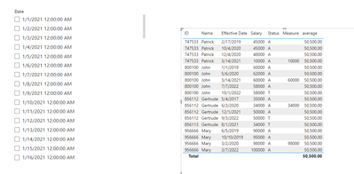

If I hvae misunderstood your meaning, please provide more details with your desired output.
Community Support Team _ Polly
@Anonymous ,
Thank you for your help!!

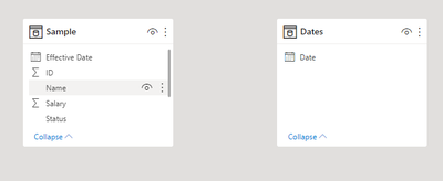

I discovered that you disconnected the date table from the transactional data in the file you sent. When I reconnect the date table to effective date, the measure breaks. Do you have a solution for this that does not require the date table to be separated?
Also, your current solution does not give the desired output when two active pay records coincide on the same date - the measure named "measure" takes the highest of all available options. To illustrate, I added a record to the sample data file so that two separate individuals have a record on the same day. The correct output would be 50,500, not 63,000:
Thank you!
Hi @sean_cochran ,
  1. disconnect the date table from the transactional data. The only one way I have: create another calendar table. If you want to achieve that, you must need a calendar table without relationship.
  2. Modify the measure.
Measure =
VAR _selected =
    SELECTEDVALUE ( Dates[Date] )
VAR _macdate =
        MAX ( 'Sample'[Effective Date] ),
        FILTER (
            ALL ( 'Sample' ),
            'Sample'[Name] = SELECTEDVALUE ( 'Sample'[Name] )
                && 'Sample'[Effective Date] <= _selected
VAR _status =
        MAX ( 'Sample'[Status] ),
        FILTER ( ALL ( 'Sample' ), 'Sample'[Effective Date] = _macdate )
VAR _salary =
        MAX ( 'Sample'[Salary] ),
        FILTER (
            ALL ( 'Sample' ),
                && 'Sample'[Name] = SELECTEDVALUE ( 'Sample'[Name] )
VAR _tstates =
    IF (
        _status = "A"
            && MAX ( 'Sample'[Effective Date] ) = _macdate,
        _salary,
        BLANK ()
    _tstates
