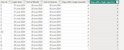

I want to build a measure which shows the number of days people login to their account per month, quarter, year.
The data is in this format - with user ID, login date. I then create end of month and end of quarter in query view and create "Days with a login (month)" and "Days with a login (quarter) as calculated columns using the DAX below.
Days with a login (month) =
    DISTINCTCOUNT ( 'Login activity'[Login date] ),
    ALLEXCEPT (
        'Login activity',
        'Login activity'[User Id],
        'Login activity'[End of Month]
Days with a login (quarter) =
    ALLEXCEPT (
        'Login activity',
        'Login activity'[End of Quarter]
I then do a distinct count of user ID to build the visuals below.
Can someone help me with the dax to build the measures which allow me to build the above visuals but without the need for multiple visuals and calculated columns?
So I want to use the dates hierarchy from my dates table on the x-axis (so I can drill up and down) and then build measures for number of people who have logged in on 1 day, 2 days, 3 days etc. So I will have multiple measures which work using my dates table and no calculated columns.
Thank you in advance 🙂
