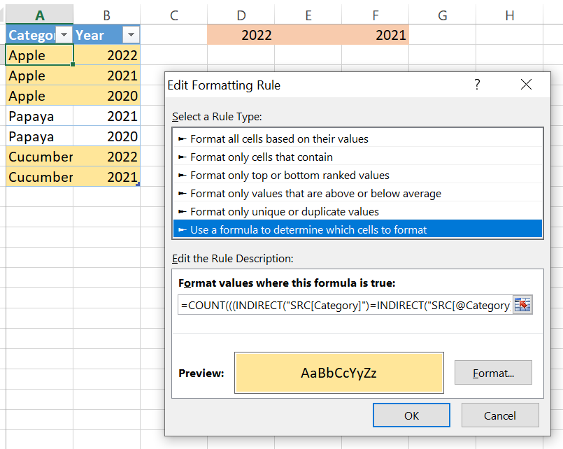

AND logic in a slicer (when multi-selected)
I am struggling to display category names based on the year slicer. When I select two different years from slicer then table should display the list of common categories that are present in all the selected years. I have pasted the sample data below:
CategoryYearunit
Apple2022100
Apple2021200
Apple2020500
Papaya2021100
Papaya202040
Cucumber2022150
Cucumber2021250
In this example when I select the year 2021 the output should be all the categories that have year 2021 i.e. Apple, Papaya and Cucumber.
When year 2020 and 2021 are selected, then table should be display Apple and Papaya.
When year 2022 and 2021 are selected, then table should be display Apple and Cucumber.
So basically, based on the years selected my visual should display the list of common categries in a table.
Appreciate any help on how to achieve this.
