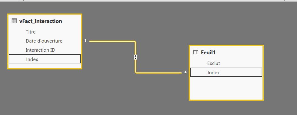

I am having exactly the same issue. I'm using a Direct Query with one fact table and aonther XLS file with the stop words. I create an index and a relationship between both tables but still not excluding the words in my visual.
Could you please help me out to understand this issue?

I am trying to use another Datasource (XLS file w/ column of Stop words) but it then breaks the visual.
v-viig
Are you trying to use another data table? What error do you get?
Pleaes note that stop words must in the same table along with data. As an another option, you can specify the relationship for two tables.

I am using a different table. In fact, using a different XLS file just with a column called "StopWords". This way I thought that I could use the same datasource in multiple PBIX where I have the WordCloud visual. In case I wanted to add a Stop Word I would just edit it so that it would update in all reports.
But from you are saying, my understanding is that I will need to have a Key Column so to establish a relationship with other tables? My other tables content can vary a little. Any suggestions on how I might be doing that successfully?
Thank you
v-viig
Yes, your understanding is correct. You have to include a special Key Column to make the relatiionship.

Even though I got the concept correct, I am still unclear on how to setup the Key Column.
Let's say that I use something like the JobIDCode which I already have in my other datasources.
I ad a JobIDCode to my StopWords file but how would it look like?
Always the same JobIDCode in each row?
Single row with one JobIDCode (which one?) and a cell w/ all the StopWords?
There is no example for this in the sample file. Would it be possible to send me an example PBIX?
v-viig
Please take a look at this sample report that represents the usage of Excludes data-field.
Please let me know if you have any further questions.
