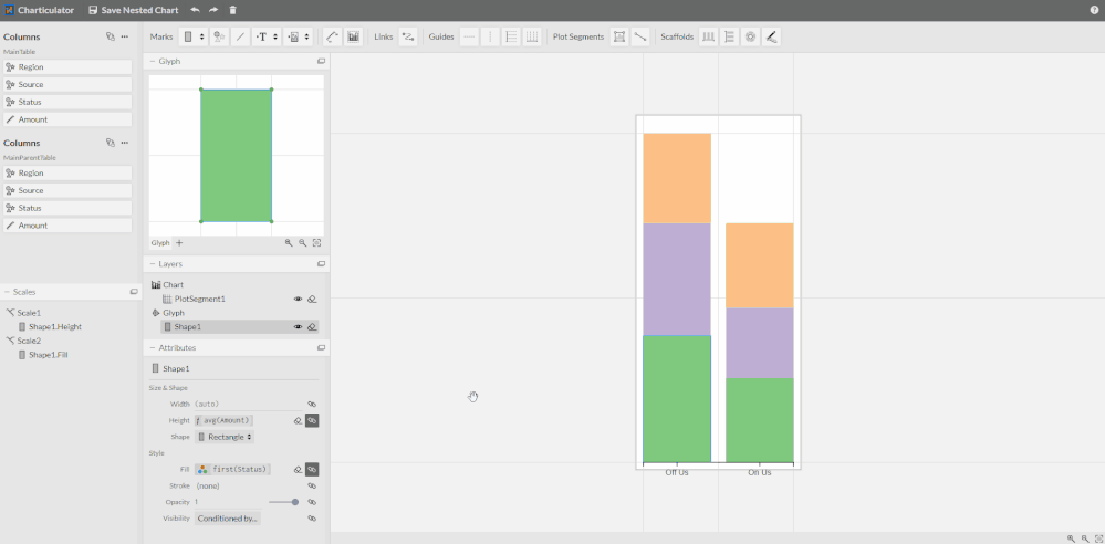

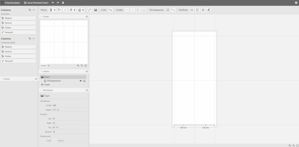

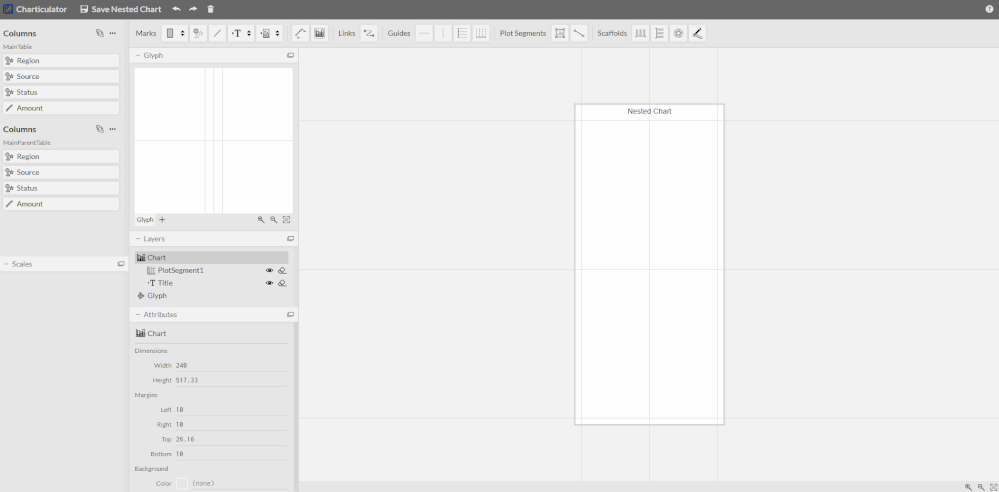

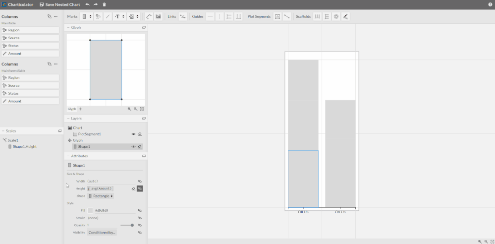

Hi @Anonymous
Unfortunately, no, I haven't written-up a tutorial on this one as they are quite time-intensive. As the chart has explicit grouping based on my sample data, it's likely that if your data contains different fields then the gropuing expressions aren't working and the tool just shows 'working'.
In terms of how I reproduced it with the same data I used (which you might be able to adapt for your data), here's the high-level process. I'm not going to spend time on formatting, just getting things where they need to be:
  1. Drag region to the visual's x-axis
  2. Set the plot segment to group by region, so you get 3 glyphs on the canvas
  3. Add a nested chart to the glyph
  4. Edit the nested chart
  5. In the nested chart:
    • Drag source to the visual's x-axis - this will group the glyphs within the nested chart
    • Change the plot segment's layout to stack Y and reduce its gap to 0%
    • Add a rectangle mark to the glyph
    • Drag amount to the glyph height
    • Drag status to the shape fill colour
  6. Save the nested chart and check the main chart - it should be as intended (in terms of layout)
After this point, you can clean-up the layout as needed. Hopefully this helps clarify how I put the original together.
Daniel
