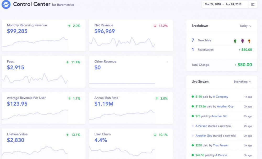

Create a compound chart using a line chart and a KPI
I want to create a compound chart using Power BI but I don't find a visualization that help me.
I want a line chart with a KPI like the following example
Hi blitwak,
Power KPI custom visual is what you are looking for because it can be customized pretty close to what you need.
You can download it from AppSource: https://appsource.microsoft.com/en-us/product/power-bi-visuals/WA104381083
