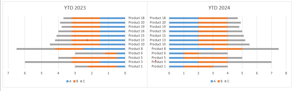

I would like to show the top 12 products sales volume in YTD 2024 vs. YTD 2023.
But I do not know how to do it in PBI.
Does any experts can provide some ideas or suggestions?
Thanks a lot in advance!

There are custom visuals that you can create that will allow you to do this, but the easiest solution for now would be to create two side by side and the invert x-axis range and y-axis position on one of them...
To create Top 12, select each visual and filter by TopN in filter pane:
Thank you a lot!!!
