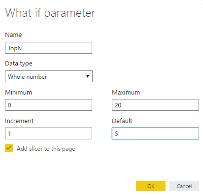

  • In Power BI Desktop, I went to the Modeling tab and then clicked on New Parameter
  • I then gave it the following properties as shown below.
  • One thing to NOTE is that I set the Minimum to 0 (zero)
  • When you are creating this TopN What-if parameter, you can change anything for the Maximum, Increment and Default.
  • I could then see the table created on the right-hand side.
  • As well as the Slicer on my reporting canvas, which I formatted

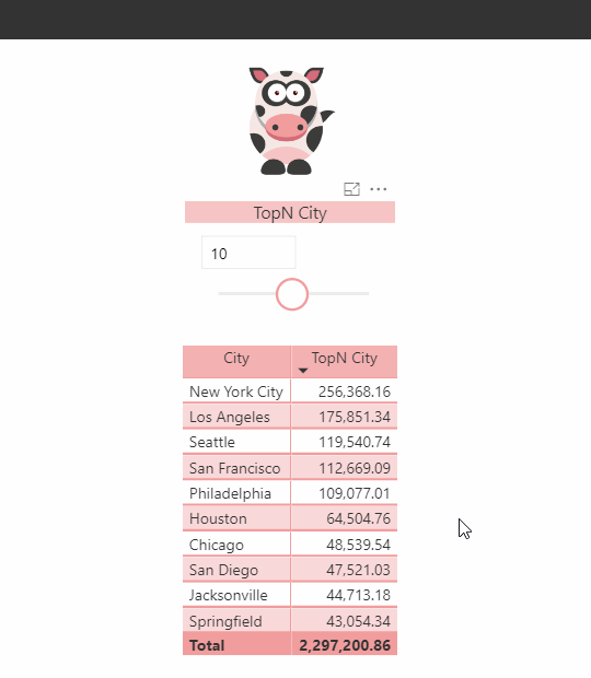

TopN Slicer in Action
Please watch the following animation below in which I will demonstrate by using the Slider I can to from Top 10, to Top 5. And then by sliding it to 0 (zero) it will show all the cities.
