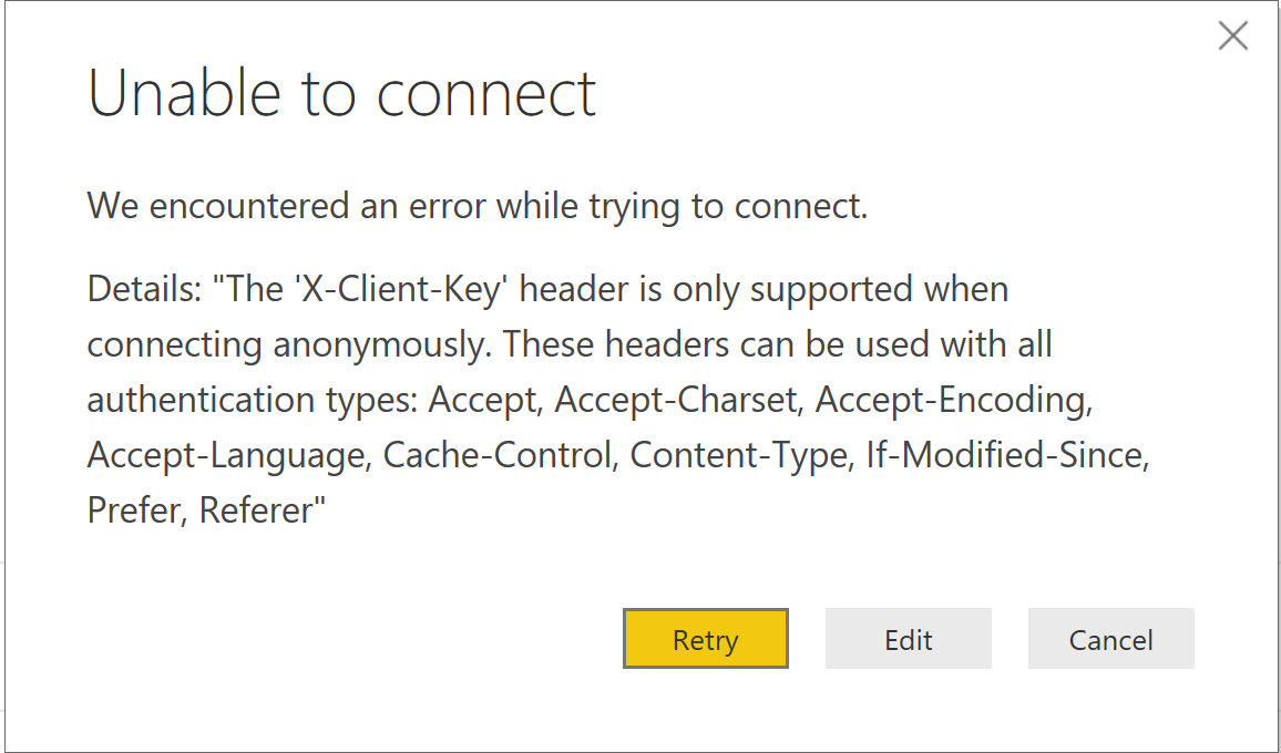

    bininja,
    As mentioned by the above error message, please use Anonymous authentication method to connect to the API.
    Lydia
    • bininja's avatar
      bininja
      Anonymous I have tried this before and this is the error I am getting.
